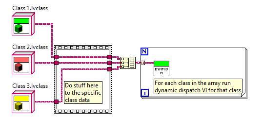

What you're trying to do is pretty simple, but you're not saving much work becuase you're going to need a dynamic dispatch VI for each child class to handle its own data differently. The benefit of using classes to do what you're trying to do is it simplifies your block diagram a lot and forces you to standardize the way you do the coding. Each child class is going to have its own datatypes and its own dynamic dispatch VI to handle its data. When each class is passed to the Parent class's dynamic dispatch VI, the code will run the Child class VIs.
See attached code to show you what I mean.
Cheers

buton wrote:
i have  PcbBase Class. which handles the functions that PcbA and PcbB have in common. How every these  Childs in some cases will require a it's own typedef cluster to parse a communication message that answers to the same command. i would like to pass that data out to other VI's
The real question is what are you trying to do with this data?  If you are actually passing the cluster out, then the whole point of Dynamic Dispatch is thrown out the window since you will have to call the specific class to get the data type you want.  You need to handle the data from within the class itself.
Message 6 of 8
(4,683 Views)
i would like to use the data on Teststand,
But you are right about that "i am throwing out the window the concept of dynamic dispatch" just wanted to see what it can be done...i can get away by outputing my data on an array and i could index it how ever i want on testand.

Thank you for the example james.
ill put some data inside the ctrol to do some other stuff
