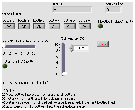

a state machine would be perfect for your application
(5,891 Views)
here's an example code...

Is this using SCADA(DSC module)? If not then can you please upload it?
(5,361 Views)
Did you actually look at the code???  Apok's example is just a simple state machine framework to explain to the original poster how to start his project.  It contains no code to actually move or sense the bottles position or weight.  There's nothing in it that interfaces to any hardware, SCADA or otherwise.
If you need a complete and operational system design based on the NI DSC module I suggest you post your request in the jobs forum or contact an NI representative for advice.  This forum is for helping people learn how to use LabVIEW.   Smiley Wink
