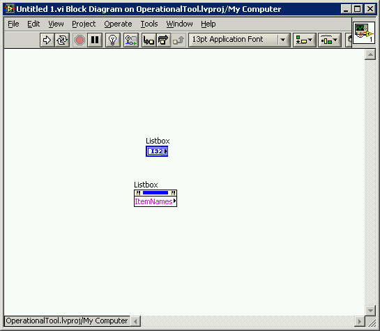

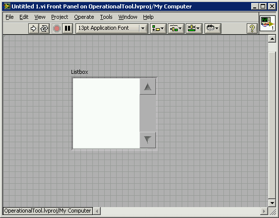

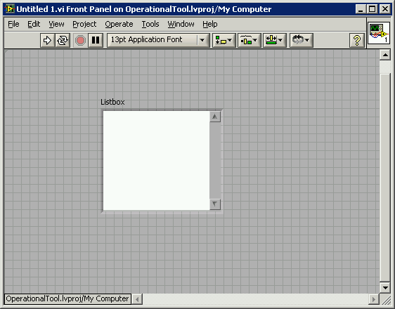

Please do the following to recreate the problem:
1. Drop a list box
2. Customize the listbox by going to Advanced -> Customize
3. Make the scroll bar bigger.
4. Go to the block diagram and create a property node of the control.
5. Save the VI.
6. Re-open the VI.
7. The scroll bar resets itself to original size.
The problem occurs only when there is a property node. It is very annoying. Is there a way to control the scroll bar size programmatically so we can work around this bug?

I can confirm the behavior.  Except the scrollbar size returns to normal even if there is no property node on the block diagram.  Making the control a typedef or strict typedef doesn't seem to help either.

Eureka!
You'll notice that when the control is built with the VI inside of a project, this behavior does not exist. A good programming practice of building applications within a project is reinforced by this work around. I'll be adding to the CAR to include the notes in different behavior.
Steps to Reproduce Expected Behavior:
1: Create New Project
2: From Project Explorer create new VI
3: Drop List Box
4: Customize
5: Choose to replace with custom control
6: Save & Close
7: Reopen Project
8: Open VI
drumroll.....
9: View that your Custom Control is still custom.
Logan H
Applications Engineer
