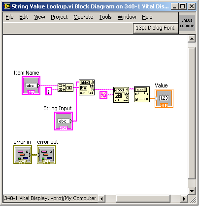

Here is the edited and working version (very close) to what Caleb wrote:
The C# DLL uses the String.Split() function to do pretty much the same thing:
