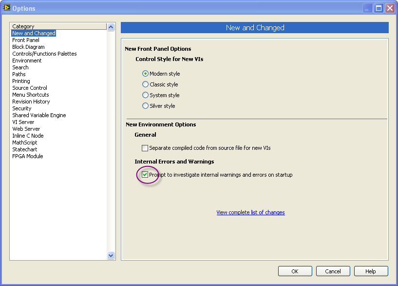

That is because when you close the LabVIEW in an improper way like killing it and if you have any vi open then you will get that prompt. You can disable that prompt in Tools>> Options as shown below

I'm not closing LabVIEW in an improper way or leaving any VIs open. I get the error if I open and close LabVIEW without even opening a VI. It clearly has something to do with a license issue.
I know I can not prompt to investigate internal warnings, but I shouldn't be generating them in the first place.
