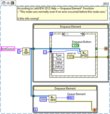

I was trying to discover why the "Dequeue Function" of my VI wasn't working and discovered a wrong info in the LabVIEW 2012 Help
According to the help of LabVIEW 2012 about Enqueue Element function:
• "This node runs normally even if an error occurred before this node runs."
I'm pretty sure this info is wrong.
Look at this example VI:
If error in is TRUE, the Enqueue Element does not work
Behavior of enqueue element and error cluster (2).pngBehavior of enqueue element and error cluster (2).png
The Online Help info is correct, but there's no notes about the wrong info inside old versions of LabVIEW

This was fixed in versions of LabVIEW not ten years old.  😉
