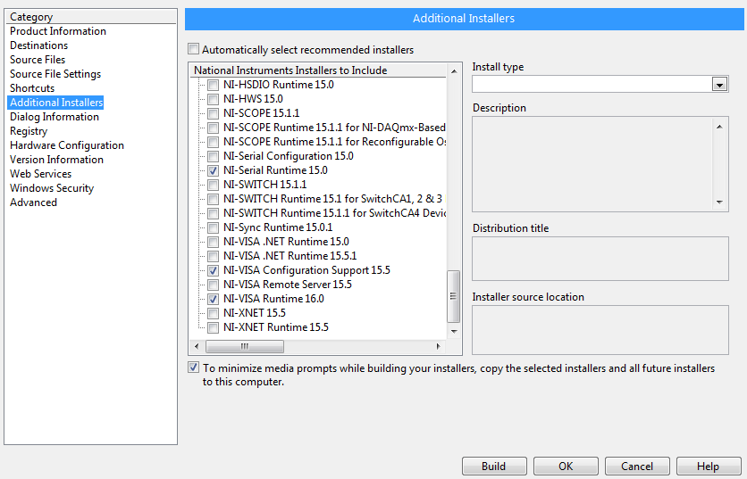

When you say "compile and install", do you mean deploying the VI that you wrote as an application via an installer in LabVIEW?  If so, you might want to verify that the NI-VISA driver set (which is what "VISA Configure Serial Port (Instr).vi" is part of) is selected under "Additional Installers" in the Installer Properties dialog box that comes up when you are trying to build.

Well, I modified my installer...
