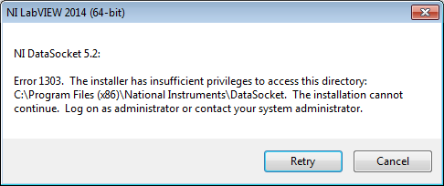

Tried downloading the new LV 2014 version via the NI Update tool (which first popped-up for update of itself).
Everything went smoothly during the download (except that there was some conflict with NI Vision - but I was not offered to update NI Vision?) but ignoring this, eventually I was told that the install failed because of some permission issue with a datasocket forlder and that I should login as an Administrator.
I AM AN ADMINISTRATOR on my machine!
I tried to find the downloaded installer to at least try to run it as Administrator (Windows 7 64 bits), but the download was nowhere to be found (thanks NI Update...not).

As I said, the install failed because of permissions rights for a specific folder. Since I could either retry or cancel, I did both (in that order), with the retry option running in a loop and the cancel one leaving me flat face in the mud with no way of finding the installer to try and run with Administrator privileges. I tried the usual NI Downloads folder, and I have no idea where this putative NI Updater Install folder may be, so for me that was "let's call it a week and wait for SP1".

Here is the message I get at the end of the failed LV installation:
Why LV 2014 64bit would need to access Program Files (x86) is left to NI to explain, but in any case, I went and checked the permissions of this folder:
Checking the permissions of that folder, neither the Administrators group nor myself (member of that group) has any right on this folder... Who does then? The folder is empty BTW, which might not be a surprise as I am not currently using any DataSocket.

For those who don't want to check the links, it is apparently a common problem during installation or pretty much any type of NI software and they don't seem to quite know what causes it, so the solution is to try a classic "Reboot and restart" and hope that everything will be fine...
And indeed sure enough, rebooting and restarting the updater results in a smooth LV installation.
End of story.
