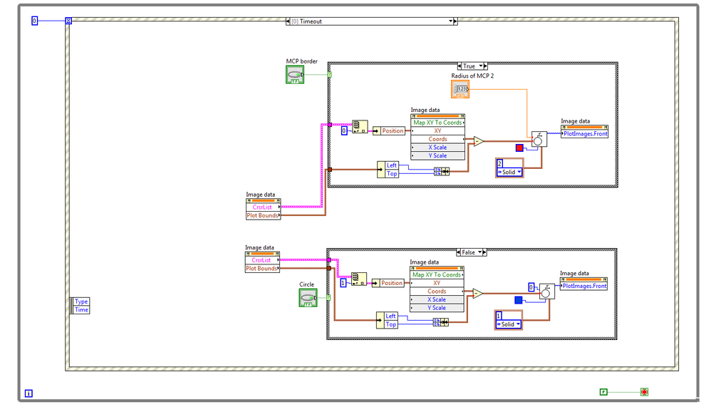

Thanks for getting back to me so quickly, here is a screenshot of the part that I'm trying to fix right now:
The first event case is our timeout, where we are trying to draw a fixed circle, centred around a static cursor, to represent the detector, and also a smaller blue circle that changes position with the a second cursor.

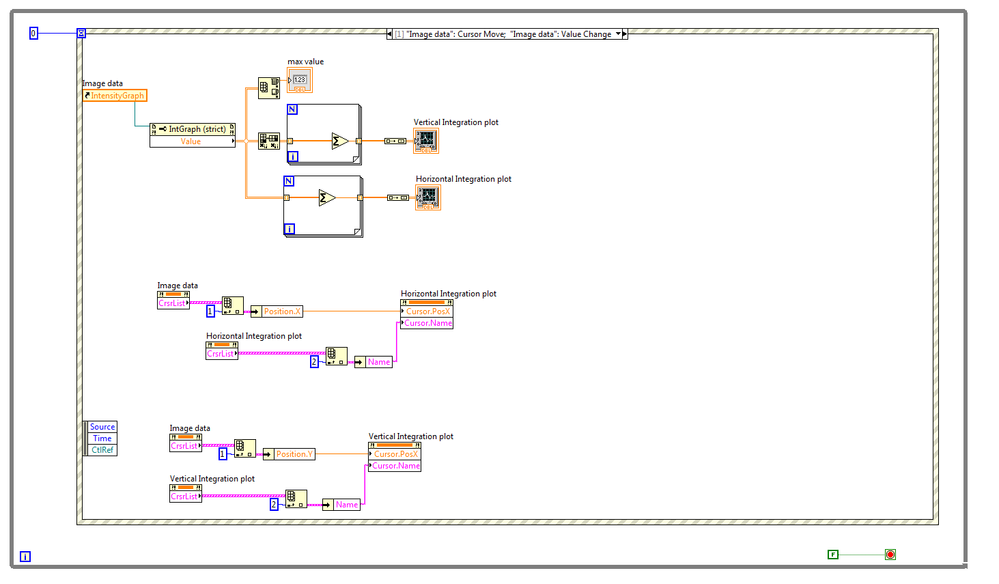

The second event case works well, but I thought I'd post it for completeness. The issue with the VI is that it was created a long time ago by lots of different people adding different functions that they thought might be useful, resulting in something of a convoluted mess that is tricky to navigate, so this may be a case where the screenshots are more useful.
In essence, it seems like the issue is that every time our camera feed updates, our circles also update - causing them to blink. I will try your suggestions and see how that works out 🙂

So we've been working at this and I think we've figured out what is responsible for the issue. When the graph updates, it redraws the image data on top of our overlay. So we have solved the flickering issue, but our overlay cannot be seen as it is beneath the image. In this case, does anybody know how to control the z-height of the plots so as to ensure that the image data is always redrawn underneath the circles?
