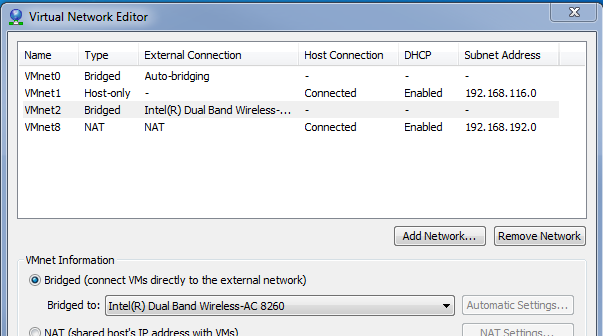

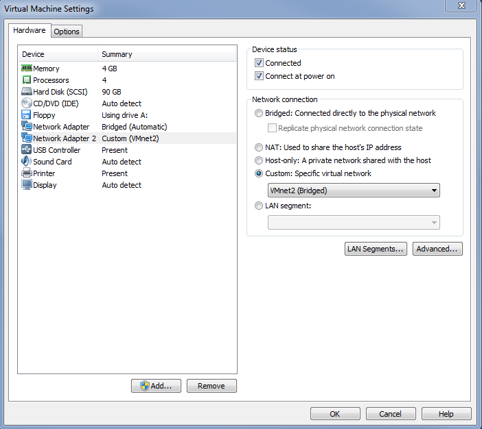

Yes, you can add a new Network Adaptor in your VM Settings. To specify a particular physical NIC you need to create a new virtual network and specify the actual NIC to use.
Looking at a basic example below (which is actually my LV2016 VM) - my physical single NIC is connected via the default Bridged (automatic) where I have only permitted the physical NIC to be used (you can customise the available NICs to use under Automatic Settings). The second physical network (Vmnet2) is connected only to my wireless adaptor. This particular configuration lets me connect to me RT Target on a local IP address but also access our source control SVN server over the company wireless. This is fairly similar to the scenario you are describing (albeit different services).
