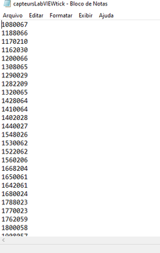

This problem (SelfRefNode "no memory" issue ) is probably due to the size of the array being concatanated array in the consumer loop (see .vi's block diagram photo attachedbelow). Thing is that for the code debugging i am reading a large .txt (~80million lines that will be converted to U32 elements,.txt file size of 800mb - and for the vi's standard operational conditions, i would like to read even larger arrays/.txt...). The txt is just a big array of integers (photo of its format below).

-As the VI starts, the exact final array size is not known, so i cannot prefix a number of iterations to "pre-allocate" the needed memory
- As shown in the attached block diagram, i read string lines (since it is a .txt file) and convert it to U32 (needed representation)
-The maximum amount of characters of each line is 10
-All this data is to be contained in wires ( i dont need to output it in indicators whatsoever), since it is to be sent to the FPGA through FIFOS.
-I read the data from a subVI (i already tried to read it from the toplevel vi, but the error persists)
- With .txt of ~250-300mb or less my vi runs smoothly
