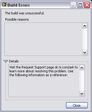

When attempting to build my executable in LabVIEW 8.5.1 I get the following dialog:
I've tried recreating my build specification, reinstalling LabVIEW, commenting out sections of my code and nothing seems to help.  Has anyone encountered this before?  Any ideas NI?

NI, what conditions cause the dialog to be blank as shown above?
