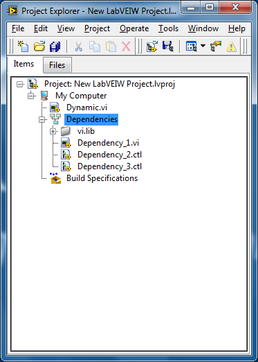

One thing that you may try is:
-> First open just the 'Dynamic VI' in a new LabVIEW project and check for the 'Dependencies'.
-> Now if any of the item in 'Dependencies', other than what is listed in vi.lib (lets call it 'Dependency.VI'), is also a part of your 'Main Exe', then its a problem. Because when you will execute the 'Main Exe', say in a new computer other than your development computer, it will load all its dependencies including 'Dependency.VI' (and the path will be within the 'Main Exe', but when it will try to (dynamically) load the 'Dynamic VI', this VI will also try to load the same 'Dependency.VI' but from different path and that will cause a conflict. I had experienced this.
-> If thats the issue, you may want to rename (add suffix/prefix) to all dependencies of your 'Dynamic VI' which is common to the 'Main Exe'.

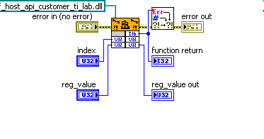

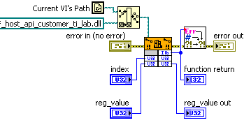

I was able to get to the next level.
I tried wiring the path to the DLL call VI and right now the plugin VI is not broken but it returns error 13 (The file is not a Resource file).
Can you suggest me what will be needed to make the dll right? The DLL is built in C++.

Seems like, this dll iteself has certain dependencies...!!
Just think about:
-> Do you install any kinda driver to make this dll work...???
-> What is the source of this dll in your development machine??? have you installed any driver in the development machine....!! if so, you are bringing this dll (by including in the installer) to deployment machine but might forget to bring this dll's dependencies, that could be anything, a header file or another dll or something else...!!
Also instead of wiring a constant path to the dll, i would prefer 'forming a relative path' (well it has nothing to do with the current issue, just based on development guidelines)...!!
