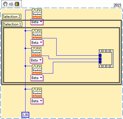

In the attached VI:
select objects following the "Selection 1" box and go to Edit>>Create SubVI.

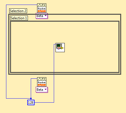

You should get something like this:
Everything works as expected (except for wire routing, but that is expected too).

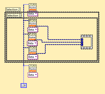

Now Undo and repeat the process using the "Selection 2" contour. You should strive to obtain that selection:

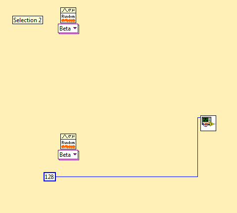

 in which the polymorphic label of the top VI is "accidentally" selected. Now Edit>>Create subVI should give you this:
Notice how the constant is now disconnected from the two top and bottom VIs.

Regarding the first question, yes. In fact this is a completely made up diagram reproducing the phenomenon, which I first noticed in my own code using different polymorphic VIs.
As far as 32 bit, I haven't tried, but I would suspect this behaves just the same.
BTW, the first picture is a VI snippet (2015 version), therefore it can be saved and then dropped into an empty VI diagram. This will recreate the VI, which you can then test.

I can confirm the behavior you're seeing.  I tried in both LV 2015 32 bit and LV 2014SP1 32-bit.
It seems like a bug to me.
One question I have for you is, if you grab the polymorphic selector as part of the selection, do you expect that function to be included in the subVI or left out, that you'd have to actually select a part of the body of the function block to be included?
It seems that LV is treating the selector as somewhat a part of the function, but not really.  Enough that it wants to break off the wire that is going to it (and for some odd reason the wire going to a different node on the diagram), but yet not a part of the function that it isn't actually adding the function to the subVI.  The scripting code seems to be in a confused state that just doesn't handle the selection properly.

Thank you for pointing this out, I submitted CAR #571520: Creating SubVI from Selection with Polymorphic VI Selector Selected Can Remove Wires and Cause Broken Wires.
