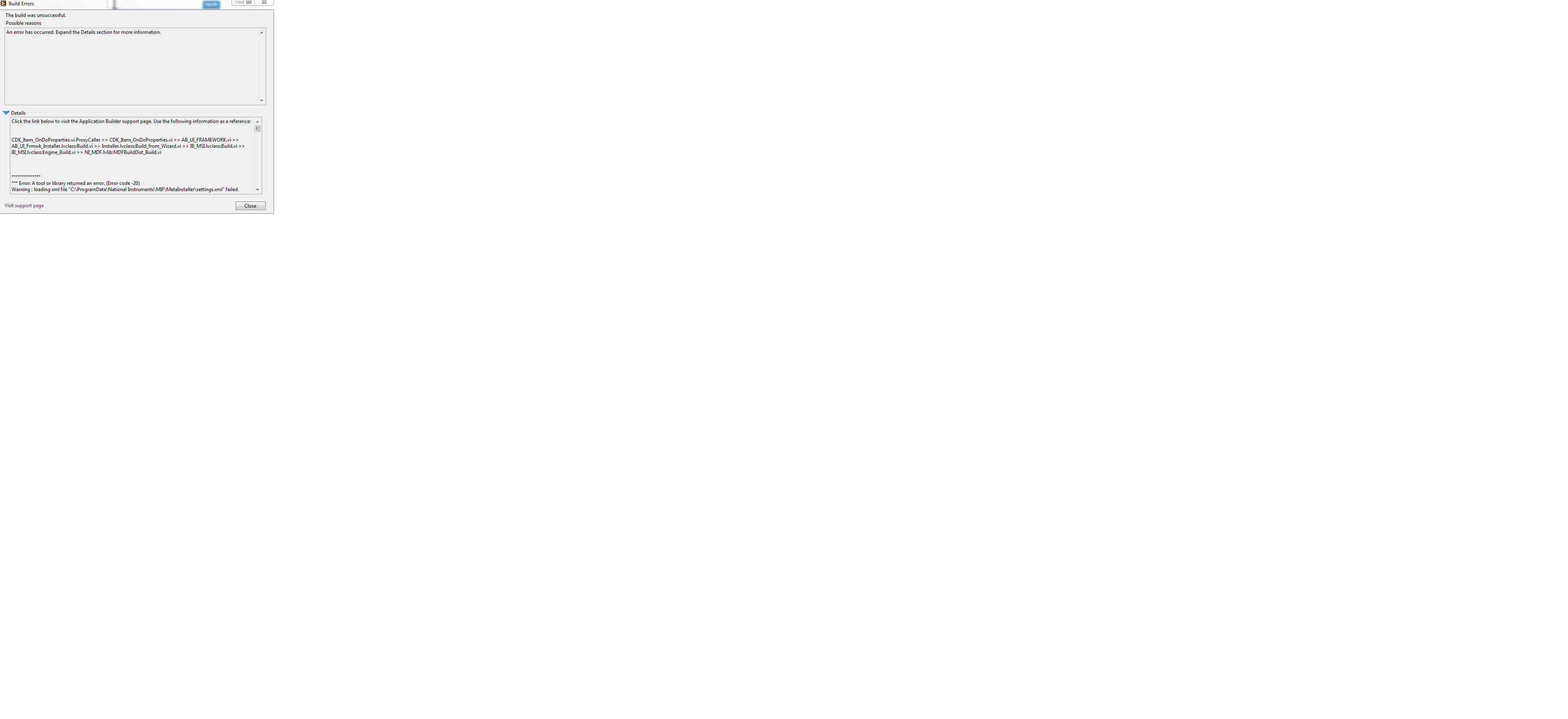

installer_error.pngEven I am getting this error
CDK_Item_OnDoProperties.vi.ProxyCaller >> CDK_Item_OnDoProperties.vi >> AB_UI_FRAMEWORK.vi >> AB_UI_Frmwk_Installer.lvclass:Build.vi >> Installer.lvclass:Build_from_Wizard.vi >> IB_MSI.lvclass:Build.vi >> IB_MSI.lvclass:Engine_Build.vi >> NI_MDF.lvlib:MDFBuildDist_Build.vi
Still not getting solution on this , can you please support to resolve the issue .

Hi diveshgarg,
Could you give me some more information on your application? Are you building an installer or an executable file? Are you using DLLs in your program? Did you include all subVIs in your build? I have also included a link at the bottom of the post that walks you through how to create an executable.
Link: https://www.ni.com/docs/en-US/bundle/labview/page/building-and-distributing-applications.html
