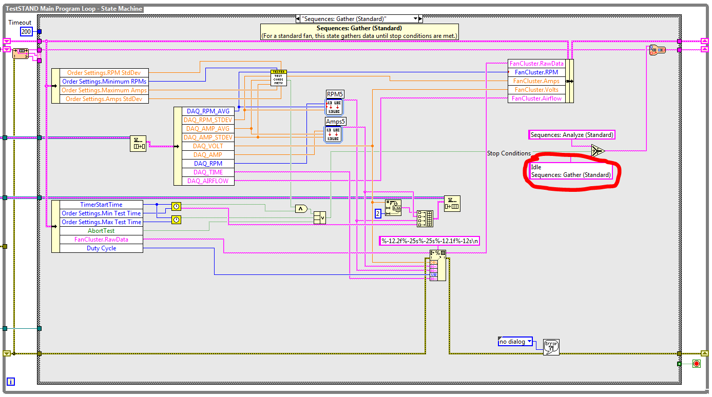

I have built a large test application.  When a test is underway, I throw an Idle step into the mix every 300ms to check for the Escape keypress to stop the test.
The event structure can be moved into it's own while loop but you don't need two event structures.  I like having the event structure in the idle state because I still have access to the data cluster.

Here is some code using JKI.  Labview 2012.
aputman
Message 16 of 18
