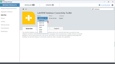

Hai I could not See LabVIEW Database Toolkit for 2025 Q1 in Package Manager
(1,295 Views)
Although it is not listed, LabVIEW Database Connectivity Toolkit is now version-independent from LabVIEW release. See Extending Compatibility Between LabVIEW and NI Drivers with Addon Support

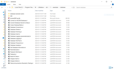

This is where LVDCT located on my PC now.
