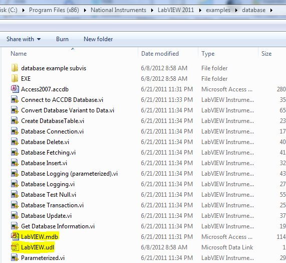

On a development system, the files that you are using are located in the examples directory (see below pic).  On a deployed system, those files (mdb and udl) do not exist because they are example support files.  You can create your own or copy them to the same path on the deployed system as they exist on the development system.  That is the reason i told you to create your own mdb and udl file and put them in your application directory so that your exe isn't tied to system examples.

Edit the udl file in a text editor and you will see why it is looking in that particular directory for the MDB.
