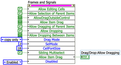

Hello all, I posted asking a question earlier about why my tree wasn't allowing me to drag and drop the controls within it. I was told to make an event structure for it, so I did. The problem is that I'm pretty sure I made the event structure properly, but I still can't select, let alone drag and drop any of my controls. Here is my code.

The property "Allow Selection of Parent Items" being set to False is preventing anything from being selected (but I don't  know why).
Also:
  1. You don't need to set properties every time.  They are retained when you save the VI.
  2. You can have property nodes linked to controls, you don't need to have a reference wired to a property node.
  3. Properties are executed in the order they appear.
So you can have something like this:

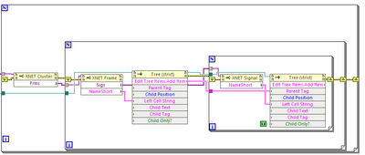

Thanks, it seems like it's treating the signals of my .dbc file as a part of the parent tag. All I did to fix it was set the "Child Only?" part of the invoke node to true (it is false as default). I kept all the property node values the same and it works as intended.
