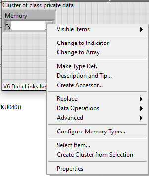

I am currently trying to script a set of classes I use on FPGA.
I'm essentially trying to programmatically do what a user would perform via the "Configure Memory Type" entry in this menu,
Part of this is trying to change the type of a BRAM reference contained within a class. When I look at the FPGA scripting VIs found under [LabVIEW 20xx]\vi.lib\rvi\ClientSDK\Core\Script I see a version for opening and modifying a "PRojectItem" BRAM and a "VIScoped" BRAM. But what I have is a FP element essentially within the LVClass Private data.
Is there any way to directly access this and change the configuration or do I need to go via a BD-node, configure it, get the terminal and create control from it to cut and replace the original with?
These are the options available, none of which work with any combination of class object, control reference or anything I can think of to wire into it. I was hoping I could directly access the BRAM properties for a FP control so that I could easily script my operations. I have had to deviate via "Create control" froma terminal and subsequently "Replace" via scripting before, but I have a sliver of hope I don't have to do that here.....
