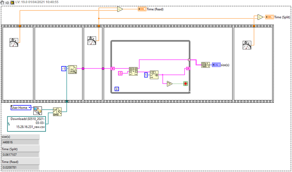

How odd...
Here's my quick attempt, but I may be committing some benchmarking failing (beyond no averaging)...
Times are in seconds, so 20 and 60ms respectively to Read the file and Split the strings.
Hopefully the Array Size is sufficient to avoid the compiler eliding the string memory, but I wouldn't be certain...
No significant difference here, but when I put the indicator outside the FSS it seemingly took longer - perhaps the array indicator was populated before proceeding to the 2nd High Res Rel Seconds. Here I ensure it is populated afterwards.

Your Inner while loop can probably be replaced by "Spreadsheet string to array" with a 1D array of strings as type, %s as format, and linefeed as delimiter. Have not tried if it gives an advantage.
Message 14 of 16
(2,026 Views)

Since the above two tools (read file and make array of lines) does exactly the same things a read lines (-1), but is significantly faster, my guess is that "read lines" is doing many incremental reads of smaller chunks. This probably could be optimized internally for this specific case. It is always faster to read once and do everything else in memory as long as we have sufficient memory. 🙂
Of course if you only want to read the first N lines (Small N), it would be extremely wasteful to read the entire file into memory. Seems like the tool does a compromise for the average use case.
