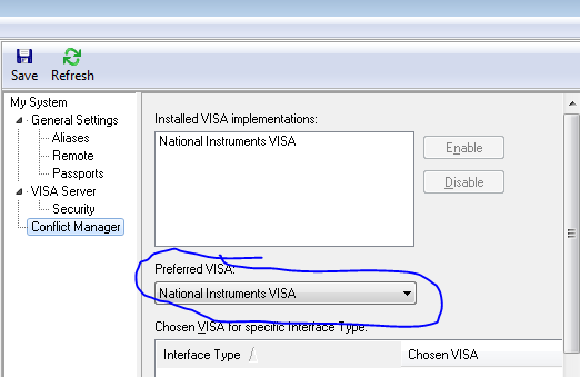

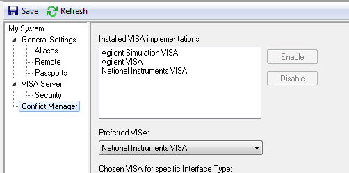

When using Agilient GPIB controllers with NI Products (Like LabVIEW) NI-VISA must be installed as the primary VISA. and enable the "tulip" passport   Agilient's IO interactive control will override this setting (Requiring a reboot to do so).
From MAX select Tools> NI VISA> VISA Options

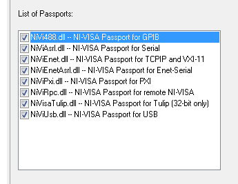

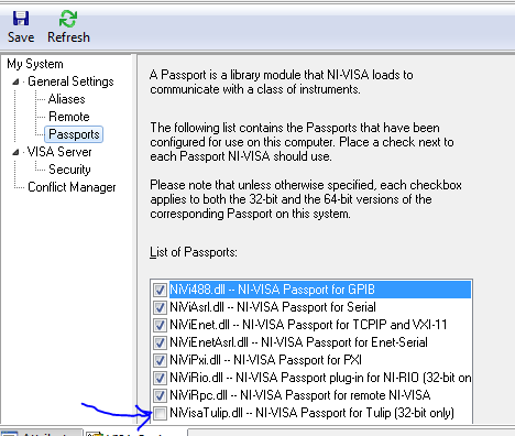

don't forget to hit the Save glyphSmiley Wink

Thank you Jeff
I have done these steps already.
Sorry for not making this clear in my previous post, but I thought saying that the insturment was found on MAX implicitly means I have set my prefered VISA to be NI-VISA and that the Tulip was ticked.
I made sure to press Save Smiley Wink

I hope the snaps below will help to explain the problem:

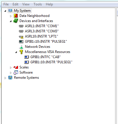

1. This what I can see on MAX:
Of course Tulip was ticked for that to happen:
Also NI VISA is my preferred VISA:

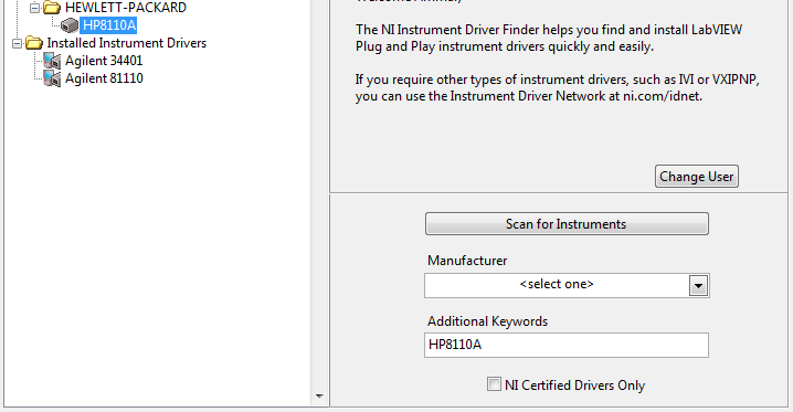

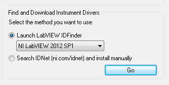

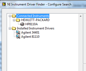

2. Then when I choose my instrument and try to find a driver:
That is what I see:
And when I double click my instrument HP8110A, this it what I get. I cannot proceed to Search, even if I changed the manufacturer to Agilent Technologies.
For that reason, I installed Agilent 81110A, because it says that HP8110A is supported:

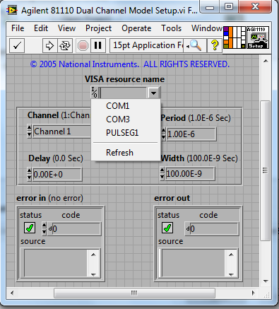

Then when I go to to run this driver, I see the next:

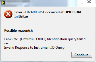

My PULSEG1 is there, but when I run it, I get the following error.
What might the problem be?

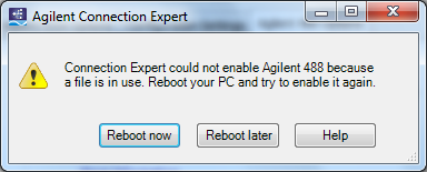

As I mentioned earlier, in Agilent IO config, I tried to Enable Agilent 488 (if that is what I really should do), but I have this popping up:
Can anyone advise me based on what I have provided, or are there still other settings I am missing?

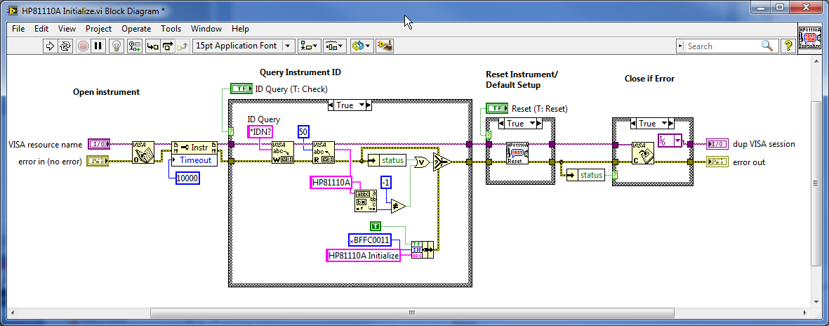

You will obviously get an ID query error since you're using the HP81110A driver to control an HP8110A. The driver expect to receive HP81110A from the *IDN? query so it will generate error -1074003951 (0xBFFC0011) if the received string is different. Just wire a False boolean constant to the ID Query terminal of the initialize vi to bypass this check.
Note that some old equipment do not respond to the *IDN? Query but I don't know if the case for the 8110A. As for the driver compatibility you will have to check the manuals to see if they use the same commands.

Hi Liira,
The error message you have suggests the hardware is a different version from the ones in the driver. We know it is slightly different as it's the 8110a not the 81110a, so this may be the cause.
I'd give this a go and see how you get on... http://www.ni.com/support/labview/visa/verr1.htm
It asks you to uncheck the ID query at the initialise vi and if the driver and hardware are compatible, it should work.

Thank you ben and James, now the machines are working properly, and I can continue my work.
When I tried to uncheck the ID Query, it automatically resets everytime I re-run the program (even when I uncheck Reset), but when I set the Boolean function to FALSE, it runs smoothly.
