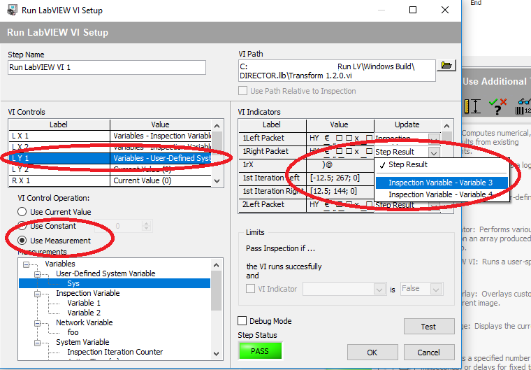

Here's what it looks like to use associate controls with variables or previous results and assign the results of the Run LV step to variables. By default, the indicator results will be logged as results of the step that you can use in subsequent steps, but you can also directly update variable values from within the Run LV VI Step.
Hope this helps,
Brad
