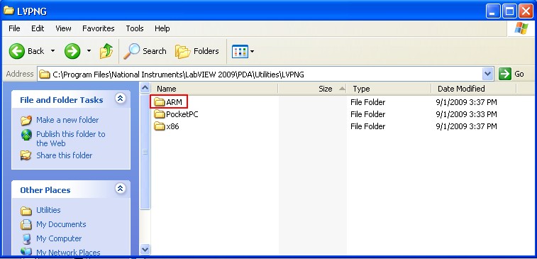

Ok,
After establishing a connection to the device using ActiveSync, we should be navigating to the PDA utilities folder on your PC. The default install location is as follows:
C:\Program Files\National Instruments\LabVIEW 2009\PDA\Utilities
Once in the utilities folder, we look to the LV PNG folder where you will see:
By running the setup.exe contained within this folder, we will be connecting and installing software to the device. Is this the process that produces the error on your system?

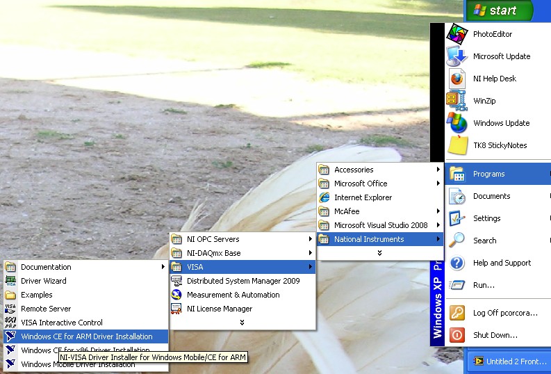

I know you have tried the LabVIEW project method, as well as manual addition of CAB files. Have we tried the VISA installation utility?
Please post back any results.
