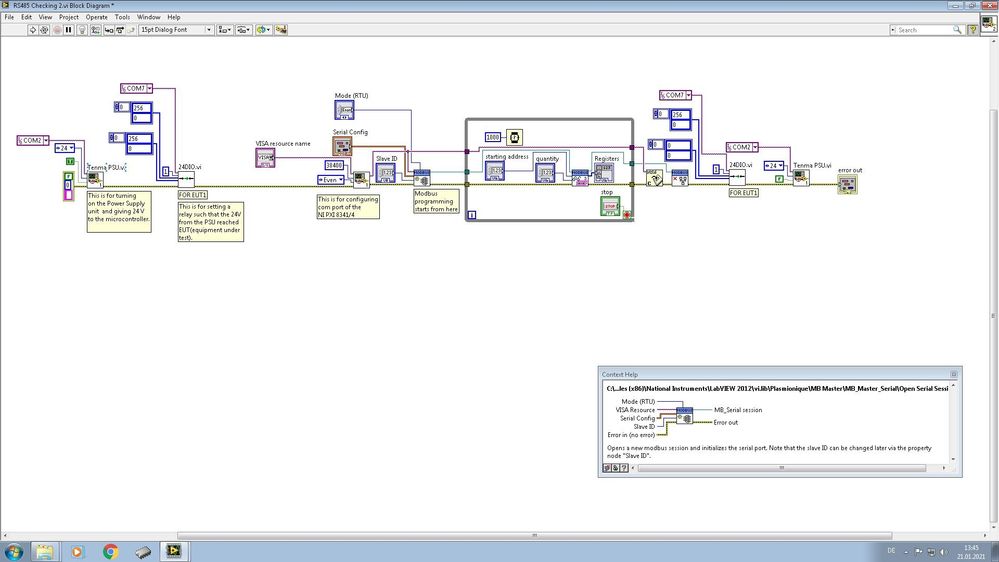

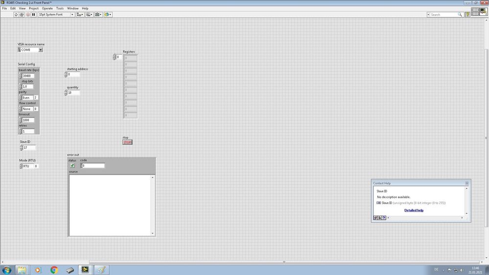

I have also attached the program which is RS485 checking. Rest are subVIs. I have configured the COM port to RS485 2 wire auto transceiver mode and still there is no output. Can you go through the program and kindly let me know what is the mistake? Thank You.
