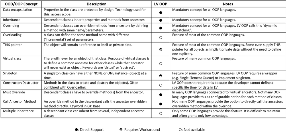

Norbert
Expert: Geometry
Message 8 of 11
(5,909 Views)
Norbert has probably just given a good answer..... I just need to find out which part of it applies...... HeartSmiley Indifferent

Overloading, which is not supported in LVOOP. If it were the OP would have his solution.
