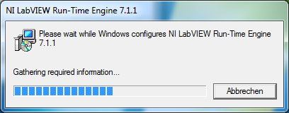

Hi all,
i have labview 2010 - 2012 versions on my PC.
whenever i start another 3rd party OPC Client on my PC, i get LabVIEW RTE 7.1.1 installation
Any help will be appreciated

Hi RENN,
Do you have the Runtime Engine 7.1.1 installed (you can find that out in the NI-MAX under Software)? If you don´t need it, you can try deinstalling it and try your installation again.
regards
René
