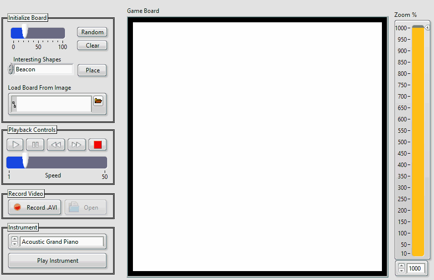

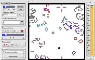

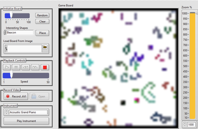

you might try to enable/disable Smooth Updates:
Spoiler
moreover,  the zoom property node appears to switch from resizing (with interpolation) to resizing (without interpolation) when some conditions are met (if smooth updates are enabled)
Spoiler
with interpolation without
    how to reproduce:
https://forums.ni.com/t5/Example-Code/Conway-s-Game-of-Life-Simulation/ta-p/3521032
Spoiler
if you need to zoom into your picture, you might consider to resampling instead of resizing

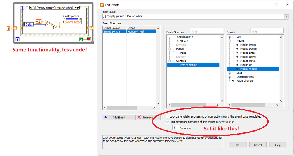

You should definitely set that to 1. There is absolutely no need to process any zoom value except the last one seen.
Events for changes of "analog style" operations (slider change, mouse scroll, cursor move, etc.) can queue up a huge number of events, so if the queue is set to 5, it will process the last five values in order when the movement ends. the first four of those are a complete waste!
For illustration, have a look at my ancient example (i.e. before the event queue configuration was available) and set the queue size of the middle event to 1 or 5 and compare.

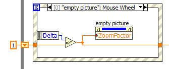

In your example, you still lock the panel and don't limit the queue size. So please change that! I think you can also simplify the event case to make it easier to read. There is no reason to hide two identical property nodes in the two cases of a case structure.
I would also recommend to keep the shift register as an integer (e.g. 2x the zoom factor), and multiply it by 0.5 for the property node. This will avoid accumulation of floating point errors. You probably also want to coerce it to 1 and above in that case (a zoom factor of negative or zero seems unreasonable).
Why not do it exponential (half or double the zoom factor with each step, for example.)
( ... and please don't maximize front panel and diagram to the screen. That's extremely annoying)
