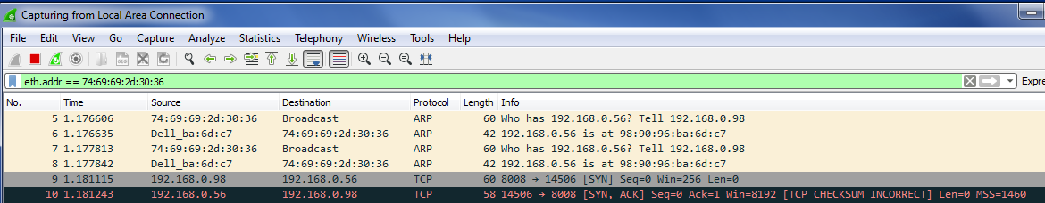

After sending and replying to ARP requests to interchange the MAC addresses, I send a [SYN] flag from the ENC28J60 and I can see that it goes to the PC and it is correct from observing the packet with WireShark. But LabVIEW only sometimes reply back with [SYN, ACK]  and then receive my message correctly. But most of the time it does not reply with the SYN flag; it just reply with the [ACK] flag which is not what I expect.
1. This shows when it works:

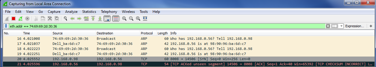

2. This is when it does not work
WireShark shows that the packets I send from the ENC28J60 are all correct and free of errors. I don't understand why LabVIEW does not reply with [SYN, ACK] most of the time (i.e. it does for few times).
