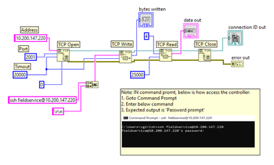

I have a challenge while implementing TCP on LabView. Though I have worked on LabView, I am new to TCP protocol on LabView.
My requirement is - I have an controller connected to ethernet and i know the IP and Port of the controller. i have created below VI and TCP read always gets timeout. I know i am missing something but not clear on what i am missing. My Expected output at TCP Read is a string (password prompt). Can anyone guide me on how to proceed.

Then you will need to implement the whole SSH protocol or use LabVIEW 2021 or buy a 3rd party tool, see here.
Sending the command line to the SSH server using TCP is completely wrong.

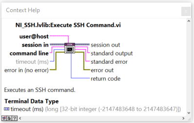

Thanks Paolo. You pointed me to right path. I was not aware that Labview 2021 offers ssh support. Have you used ssh function Labview 2021? I dont see any examples to understand this function. Di you knows what is command line here?

Have you ever done SSH communication through a command line tool? Basically the command line string is the same text you would enter on the SSH command prompt in your command line tool. You may have to experiment if you need to append the LF, CF/LF EOL character sequence explicitly or not but other than that it should be the same.
After each command you send you receive the response and then can send another command on that same session.
