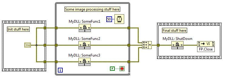

MTrivedi wrote:
But now the problem is there when I am using same halcon DLL function multiple times parallel in labview
Do you mean this?
Or are you calling SomeFunc1 several times (SomeFunc1 = SomeFunc2 = SomeFunc3 on the picture)?
Message 56 of 63
(8,149 Views)
Yes exactly but still same error occurred
