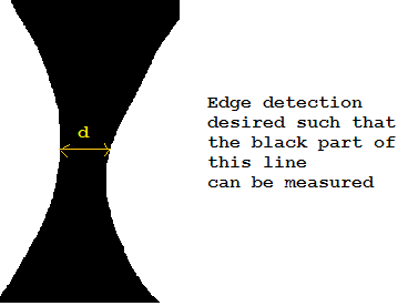

My Boss wants me to try to find a way to quickly extract some measured edge detection, given a set of jpg images.
The idea is to measure the minimum distance across the black boundary as shown in the attached image. (Just one measurement of distance across the boundary)

A possible way of doing this, is using the edge detection.  Don't use it from outside to inside, but from inside to outside.
It will detect the left point of your arrow (d) and the right point of your arrow (d).
When substracting the x-positions => width.
If you need it, I can set you up an example, but you can use the vision builder feature as well, which is a really easy and convenient way of testing things without having to program.

I guess I would need to define a region of interest in all the jpg's.
Then from there I would have to have the data inside region of interest converted to Binary Black/white contrast to make edge detection simpler.
Then from there do some kind of scanning from left to right or vice versa to first find and then define the edge of the shape.
(I do not think the center outwards would not work for me because the shape is always changing and thus there is no static center. Our camera is not stabilized so there
may be some horizontal jitter in the image from the physical shaking that may be occuring during video acquisition.

If you wanted to do this in LabVIEW you would need to get the Vision Development Module. This includes many image processing VIs that you would need. If you know where on the image you want to me measuring (y position) you could do a single horizontal line edge detector to find both edges and then use the positions to find the width. You could do a similar process in Vision Builder AI if you did not want to develop code in LabVIEW, but those would be the two easiest options.
