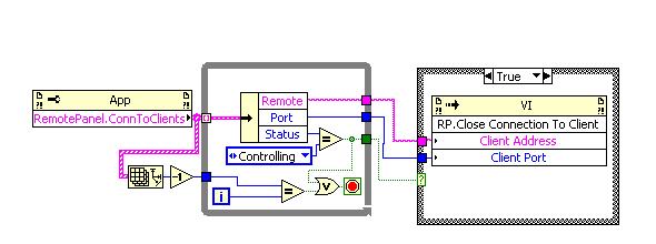

Or is there a way to programmatically terminate the client connections? I tried using 'RP.Close Connection to Client' method in vain. If there is a way to terminate then I could use that to close connections before closing the VI.
(3,641 Views)

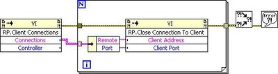

Similar one except that I'll not check the client status. I'll close irrespective of its status.
(3,632 Views)
Accepted by topic author Priyadarsini
Oops.. The 'Close Connections' method is working properly. I apologize for the mistake.
As for the application crash problem, I did this close connection, then wait for a few milliseconds and then exit the VI. Now the application seems to be working fine.
