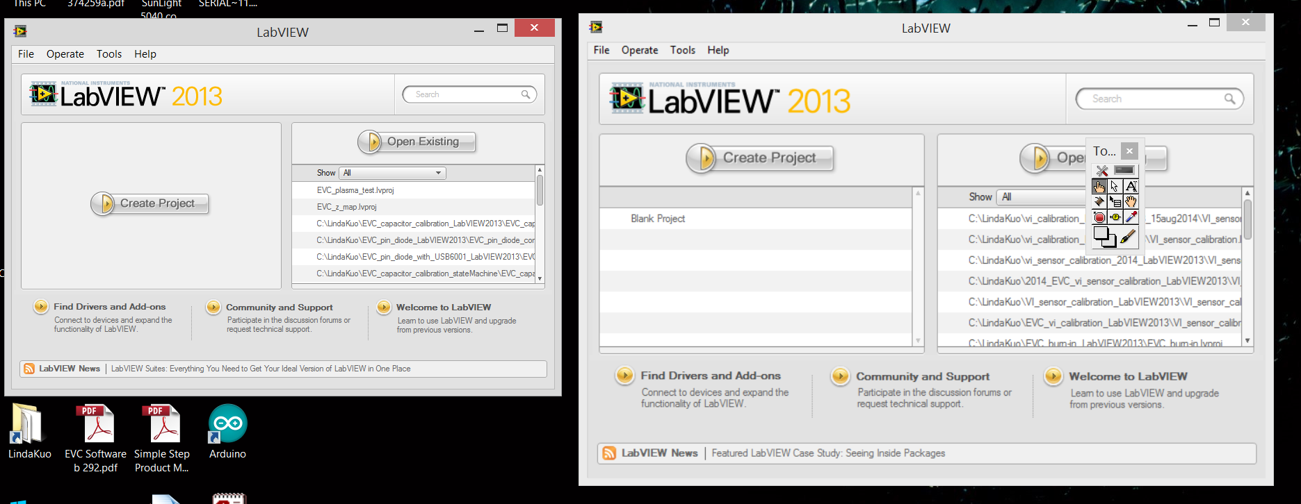

I have both LabVIEW 2013 32-bit and 64-bit installed and LabVIEW 6.1 installed.
For unknown reason the 32-bit version is starting up default Application font of 20 bit.
Everything about it is "smaller".
I am attaching a PNG file below showing what I mean.
The left is the start-up screen for the 32-bit version, The right is the start-up screen for the 64-bit version.
I want to get the 32-bit version back to what it was yesterday.

I did. The only entry I see for fonts is FPFont="0" 20 which I changed to FPFont="0" 15.
It isn't just the fonts.
All of the panels, etc. is scaled smaller as you can see in the PNG file.
So it seems that the font is being increased to 20 from 15 to compensate.

Instead I re-installed LabVIEW 2013 32-bit. I deleted the .ini file and the .conf files, just to be certain to start fresh.
This worked. Yay!  I am going to make a backup of the Labview.ini file.
