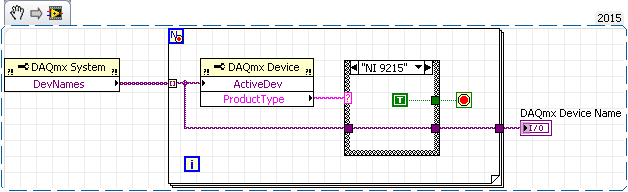

Try using the System and Device property nodes (on the DAQmx>Advanced>System Setup palette). The snippet below will output the device name of the first 9215 module that it sees.

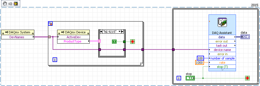

Ok, I see that you're using DAQ Assistant. In this case you can programmatically tell it which device to use with the "device name" terminal:
Message 4 of 9
(7,761 Views)
What is the block inside that says NI9215? Im trying to find it and cannot...
Message 5 of 9
(7,748 Views)
That's a case structure. Are you running LabVIEW 2015? The picture that I posted is a snippet, which means you can click on it with your mouse and drag it onto your block diagram, and it will add that code to your VI.
I should probably explain what the code is doing. The DevNames property is an array that contains the name of each DAQmx device that you have in your system. The For Loop executes the code inside for each element of this array, one at a time. The ProductType property is a string that describes what type of device is wired into the ActiveDev terminal. This string is wired into the selector terminal of the case structure, and I've defined a case for "NI 9215". So if the ProductType string of that particular item in the DevNames array is "NI 9215" then the code inside that case is executed, which tells the VI to stop the For Loop and send the device name for the 9215 to the output of the loop. I've also defined a Default case, which tells the loop to keep iterating through the rest of the elements in the DevNames array. If it gets to the end of the array without finding a 9215, the loop will output a blank device name.

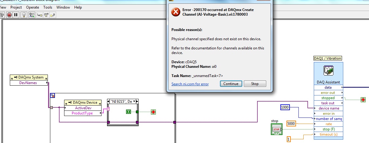

I am using 2014. So I did figure out the case structure, and I thank you for your explanation. I was able to re-create it but when I run it I get an error. Note I am only using channel 0 on the 9215.

Specifying Default in the case structure means that case will execute for any input that doesn't already have a separately defined case. Your "NI 9215" case also includes the Default in the same case. So if the first item in the device array is your chassis (cDAQ5), the code in the "NI 9215", Default case will still execute because there is no other defined case for "cDAQ5". This means the loop will stop and the "cDAQ5" device name will be sent to the output of the loop, which causes the error you are seeing because the DAQ assistant needs the entire name of the module. Your case structure needs to have two cases: one for "NI 9215" and one Default case to handle everything else that isn't a 9215:
Also, by putting the property nodes and For loop inside your While loop as you've done, you're telling it to execute that code repeatedly, when you really only need to get the name of the device once. Put these items outside the while loop and only wire the device name into the loop, as I've done in my example.
See the attached VI.
