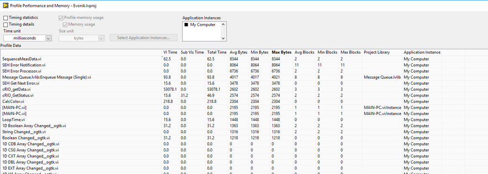

I checked my code, its really a lot and likely not useful to post, with 'Analyze VI's' to maybe detect some obvious errors but there were no errors only a lot of suggestions and I couldn't see these as the source of the problem. So I also checked the code running with the Tools - Profile Performance and Memory.. function in LabVIEW 2017 but also no luck, can't see no memory increasing in any of the VI's
