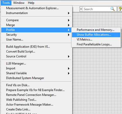

@Now_With_Underscores wrote:
There's a way to show all memory copies (Tools»Advanced»Show Buffer Allocations) in LabVIEW... I recommend using that to see where the real memory shark is.
I couldn't find this option, neither for Front Panel, nor for Block Diagram. I am facing the memory problems in my application, and came across this thread while looking for some solution.

@Vaibhav wrote:
I couldn't find this option, neither for Front Panel, nor for Block Diagram. I am facing the memory problems in my application, and came across this thread while looking for some solution.!
 It is in the menu of the diagram windows in all recent LabVIEW versions. What version of LabVIEW do you have?

Thanks @altenbach and @Neon
I use LabVIEW 2013 SP1, but as Neon showed, this option is in a different location, not where I was looking for based on that original comment.
