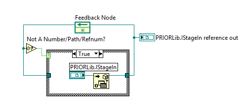

In the VI where you open the reference, can you change it to be like this:
(The False case just sends the wire straight through)

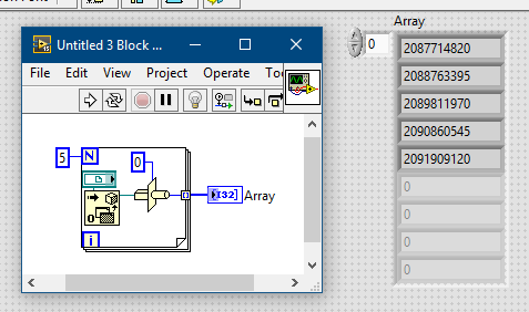

The reason is that each time you open it, it actually makes a different copy of the reference.  So after a long time, you have a gajillion copies of the reference and it can't handle it any more.  Here's a quick illustration of opening 5 in a row:
You can see that each time it runs, it is actually a different reference under the hood, even if to LabVIEW they all act the same.
