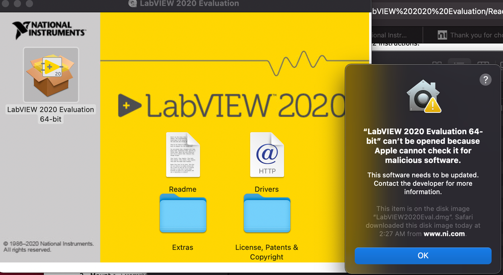

LabVIEW was inspired by and born on the Mac.  Wouldn't it be great to see it born again on world class hardware!Screen Shot 2020-11-18 at 2.31.40 AM.png
Screenshot from my MacBook Pro (M1)

Dear Carsten, Were you able to override that message in the system preferences? Lab-view has been saying that for some time even on intel macs unfortunately and the only fix was to go into Security and Privacy to choose install anyway.
I’m considering an upgrade, but need to use Labview so I would appreciate any news on wether you got it successfully install.
cheers, martin
