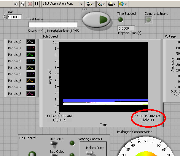

To avoid burying the lead, I'm going to state the problem I'm having straight off. The program I'm written pauses exactly every 10 seconds while running, always on a time where the seconds are around 3.6 (see below, as low as 3.4 and as high as 3.8). the pause is very short, easy to miss. I only noticed it because we recorded over the pause a few times and the data columns got swapped.
The timing of the pause appears to be independant of the sample rate. I've gone as high as 200k and was able to repeat it as low as 50k. Below 50k I cannot reproduce the error reliably. Once the error does occur it happens exactly every 10 seconds (down to the millisecond). For example, on one run I get the error at 11:06:13.681, it will occur again at 11:06:23.681, at xxxx:33.681, xxxx:43.681, etc...

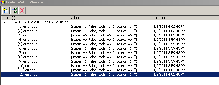

The last VI you posted has no file writes at all. How are you determining that there is a pause? What is the duration of the pause?
You also have no error handling. At least place a probe on the error wires to verify there is nothing being generated there.

However, this appears to be independent of the file write. I took the file write VIs out to verify that the file write wasn't causing the problem. The problem persists, when the program is running it pauses at roughly 3 seconds and then exactly every 10 seconds after that first pause. It's very brief, just long enough for someone to notice it if they're looking. You blink and you miss it. I'm not sure how long that would be, 50 - 100 ms maybe? By pause I mean the VI freezes, the counter stops briefly and then starts up again. It doesn't reset.
What's bothering me is that it's ALWAY at 3.x seconds and then exactly 10 seconds later on every iteration. It could be at 3.721, 13.721, 23.721 etc... OR 3.654, 13.654, 23.654, etc... A small variation on the 1st decimal with each start/stop of the VI, as low as 3.4xx and as high as 3.8xx, but otherwise the same no matter how many times I start and stop the VI. No stops in the 2 second or 4 second range, only roughly 3 seconds.
I can run the software as high as 200k and as low as 50k and reliably replicate the error. At 40k it happens sometimes, at 30k less, at 20k I really can't get it to go. Possibly I just can't see it in that range?
Added the probes all over (great suggestion, feel a bit silly for not thinking of it). Nothing 😞
One would thing this would throw some kind of error! I'm adding in the error handling though.
