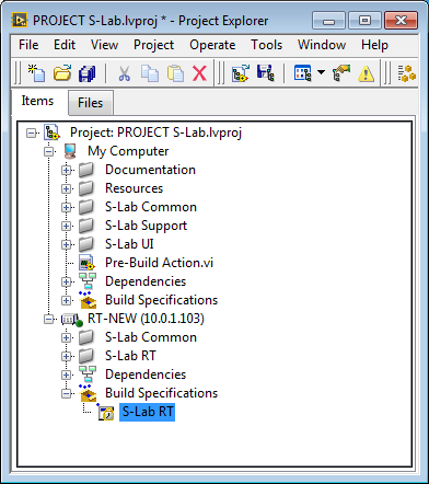

I apologize for not following up on my Post of almost seven years ago.  About two years after that Post, I had found a way to deploy my Real Time Project as dual Executables, an EXE that ran on the Host, and an RTEXE that ran on the PXI Target, set to Run as the Startup Application.
As it happened, I had LabVIEW 2012 (later updated to 2014) installed on the Host, connected via a dedicated line to a second NIC on the Host with an IP in the non-routable 10.0 sub-net to the Target PXI, so it appeared in the Project.
The Build Spec had the following settings:
  • Information page
    • Target Filename:  S-Lab RT 2.3.rtexe
    • Local Destination:  C\Users\Public\Documents\S-Lab Builds\S-Lab 2.3\S-Lab\S-Lab RT
    • Target Destination:  c:\ni-rt\startup\S-Lab RT 2.3
  • Source Files -- S-Lab RT.vi is the only entry, in Startup VIs
  • Destination -- Label and Path same as on Information Page
  • Other choices left as default
After Building, I did a Deploy and set it to Run at Startup (of the PXI).  The RT Code, itself, was set so that when the Host exited, the Target code also exited, with the last VI being a request (using the Restart VI) to reboot itself.  I also wrote a "Reboot" TimeStamp into a Reboot Log on the PXI as a record of the Restart (why not?).
I hope this answers your question.
Bob Schor
(5,542 Views)
