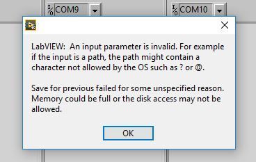

Disregard the executable application that is said earlier. that's my mistake sorry.
all i want to do is to save my .vi in 2014 version.
i tried to use "save for previous" but this error occurs. i tried to check  what the error said and i did not violate any of those.
(3,157 Views)
disregard the executable application that i have said.
i just want to save my .vi in 2014 version.
i tried to use "save for previous" but this error occurred. i have tried to check it and im all good but still this problem.

Accepted by topic author 1der-er
Is the VI file set to Read Only?  Is the VI password protected?  Are you trying to save to a folder that you do not have write access to?
If you just post the VI, I can try to convert it for you.
