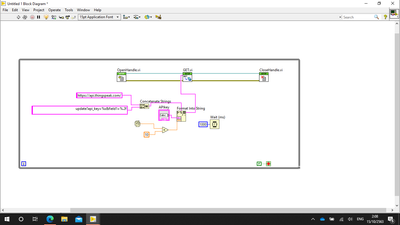

Hello everyone, I need help or advice. I want to send a value to the thingspeak but it doesn't seem like it will be able to send it up, do you have any advice?
labView 2018 thx

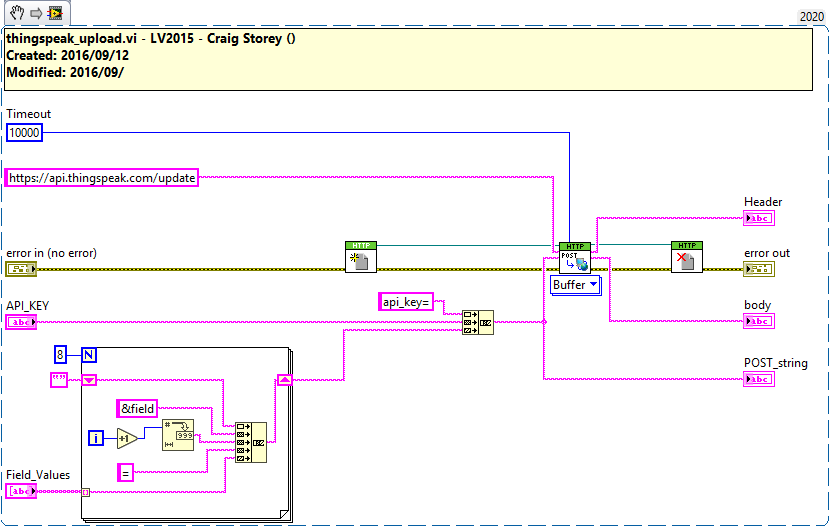

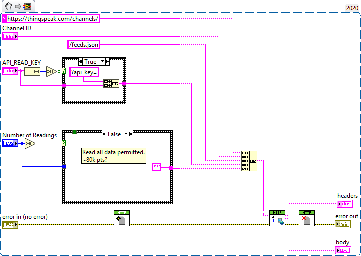

I made a few subvis awhile ago to play with Thingspeak.  You need to have your channel and API keys to use these..
Uploading..
Downloading..
Hope those help.
