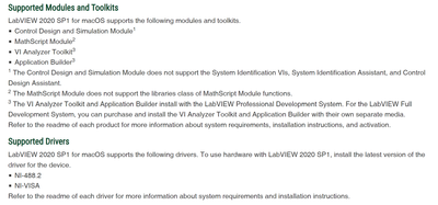

Hi again
There is no 48 GB download for macOS.
What you can download is this :
The four modules listed is included in the 2 GB download. One is the now defunct CDS module for those interested.
The only two drivers you can add to macOS are NI-VISA and NI-488.2. Nothing more.
The drivers are separate downloads :
Regards
(1,177 Views)
