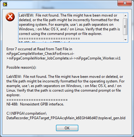

Thanks for your quick response. I have attached the image of the error below.
I tried compiling the same FPGA vi on a different system (laptop) this morning, and it compiled successfully. However, I couldn't get it compiled on my desktop. Both have the same OS - Win 7 and LabVIEW 2012 installed on them. Kindly let me know if you need some more info.
Thank you once again.
Chetan

I would imagine that it, once again, is an issue of some Xilinx tools not being able to run due to some issue with the Xilinx tools as installed on the machine that has the compile worker on it. Can you attach the full Compilation logfile?
Message 22 of 24
(1,315 Views)
Hi Brad,
I think the problem is solved. You were right about the possible issues with the Xilinx tools. I re-installed Xilinx 13.4 on my system and rebooted it. The compilation of the FPGA VI completed successfully. Thank you for your suggestions.
