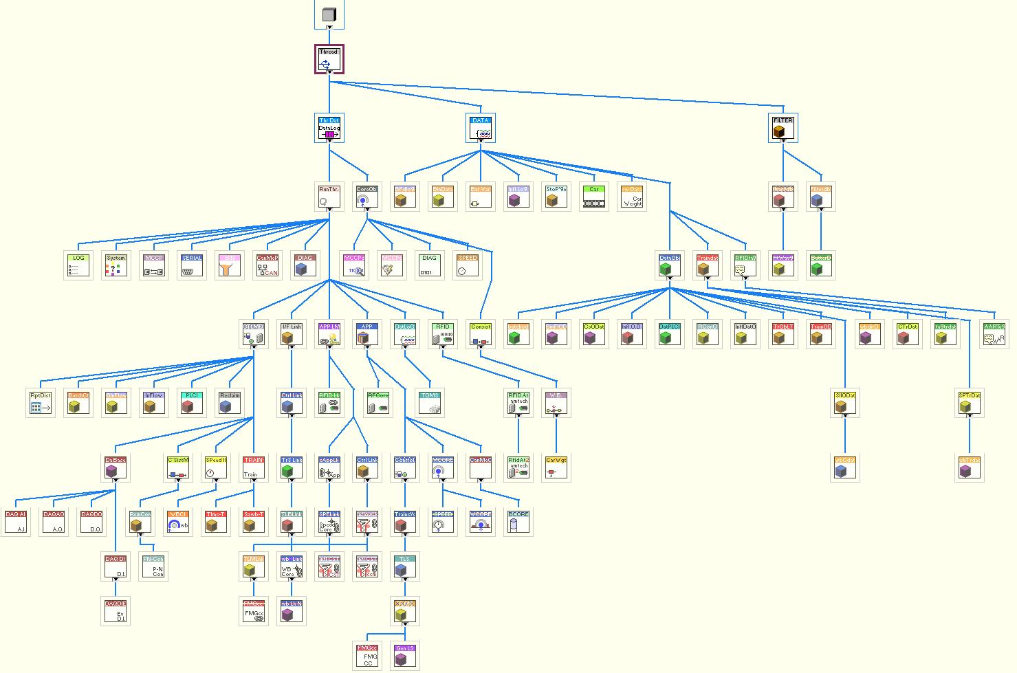

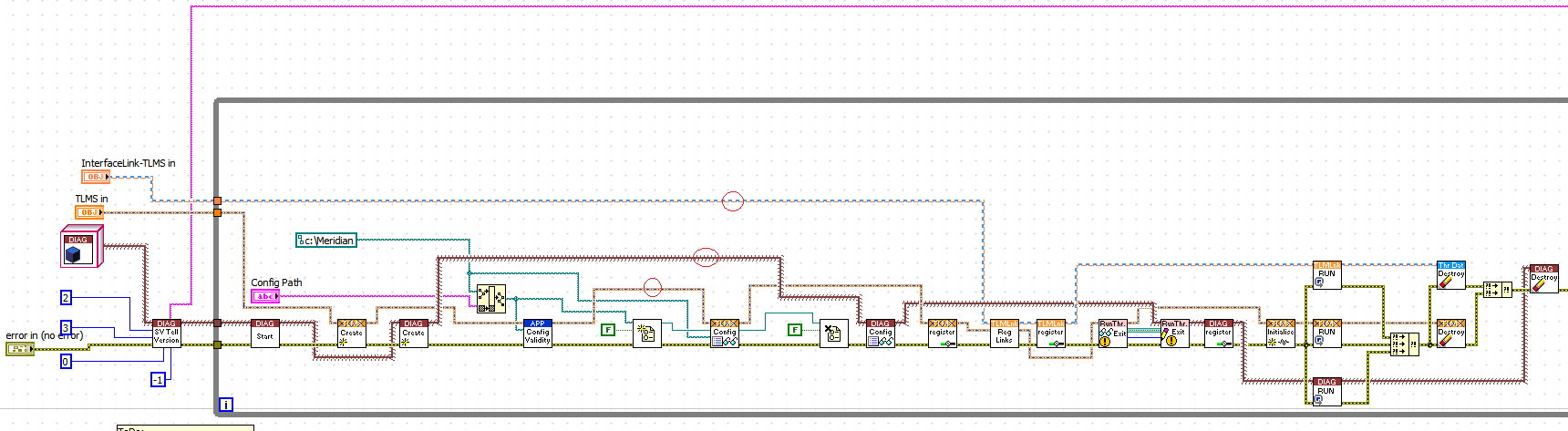

Below is a taste of some different wire patterns and my "thread" base class methods, create, register, run initialise destroy, I use this sort of pattern extensively.
You can also see a ancestor class calls with different headers.
I looked at my heirachy and found I had added glyphs to about 25% of my classes, So, I am a bit lazy as well.
I guess I have been adding them to important classes and base dynamic functions

Looks like slick LVOOP code to me. Smiley Happy
Are you _sure_ it does not run on the RT? Crashes or just takes a long, long time to start?
Have a good looooong look in the CPU/memory load of the target in the "Distributed System Manager"?
As long as LVRT is loading up on the target the memory and CPU will be changing a lot and with such a large class hierarchy it could take a few minutes(!) for everything to get up and running from the rtexe, specially on the relatively slow c/sbRIO's.
Also, if the problems are path-based lookups of classes and methods, I use the following pattern(s) (red arrow indicates base class method:
or:
Seems to work for me "most" of the time since building (rt)exe's makes all path references go haywire, so it is better to let LV help me out find the correct paths. Maybe this is what you already have? "just sayin". Smiley Embarassed
