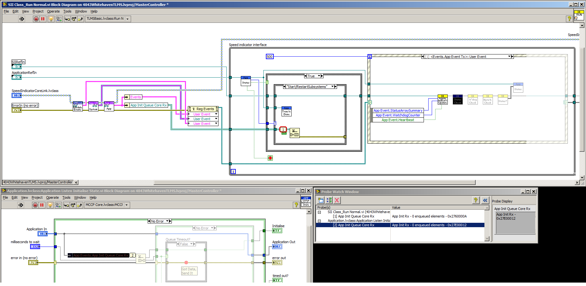

Here is another Nail:
Why am I working Saturday morning (Because I am Debugging Labview!)
I have 2 seperate threads that have the same base class.
I have found one class consuming queue commands from the other.
Ah, You say, Bad Programming, You have shared a Queue you Noob.
Alas, this is not the case, I have checked the References, they have different Hex values (See Attached)
They do share a Queue Check .VI though, it reeks of some sort of Buffering problem.
iTm - Senior Systems Engineer
uses: LABVIEW 2012 SP1 x86 on Windows 7 x64. cFP, cRIO, PXI-RT
