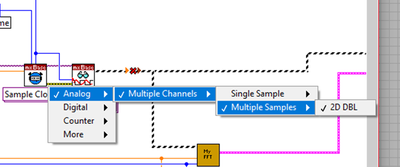

I am working on a program for an engineering class and we are supposed to use the Read VI and have it output an Analog Waveform 1 Channel Multiple Samples. I'm using the program our professor designed but the Read VI won't output as a Waveform. I have plenty of options but for some reason it won't output the Waveform format. We are using a DAQ and I downloaded all the needed software (I think) but no luck, even after reinstalling everything.Read VI Outputs.png

maybe because your are using DAQmxBase and not DAQmx?

I looked and I actually had BOTH installed. I uninstalled the DAQmxBase and then found that the full DAQmx was the wrong version,. I had the newest version (19.6) but the newest LabVIEW 2014 can use is 17.4. Everything works now. Thanks for the help!
