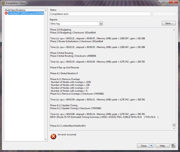

In my project I use 14 memory blocks. LabVIEW 2014 migrated all of them by default to 1 cycle of latency although the documentation says the default are 2 cycles.
Beside the block diagram changes caused by the new object size, that setting leads to an FPGA compiler error.
This error can be a compilation error as shown or simply an infinite wait at phase 4.1.2. Update Timing...
LabVIEW2014 Help
Cycles of read latency—Specifies the number of cycles of latency for the Read (Memory Method) of memory items implemented using block memory. The default value is 2 cycles of latency. ...
Note  When you use the Read (Memory Method) within the single-cycle Timed Loop for a memory item implemented using block memory, the number of Feedback Nodes or uninitialized shift registers wired to the data output must be greater than or equal to the number of Cycles of read latency. If you do not wire enough Feedback Nodes or uninitialized shift registers after the Read (Memory Method), the FPGA VI fails to compile and LabVIEW returns an error.
________________________________________________________________________________________________________________________________________
I had to change each block memory property to 2 cycles of latency to get a successfull FPGA compile build, although I don't use the Read memory method within SCTL's.
