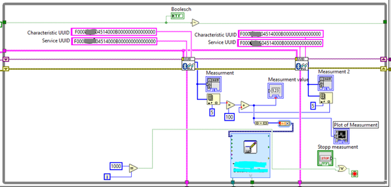

Labview BLE toolkit with bled112, too slow in reading data!!! Can I read 16 Bit data, can I use notifications instead of polling?
I am using the BLE toolkit to read one characteristic. Unfortunetly this charateristic has 16Bit. As in the toolkit only 8 bit can be read, I spitted my data to send it in two different 8 bit characteristics. This makes it much too  slow. At the moment I am polling the characteristic values in a loop.
Is there any way to make the readout quicker? Is there a way to receive notifications?
I set the baudrate of the com port to 112500.
I would be very happy about any suggestions.

True, I thought about that as well. But I read a lot of foren post which said that ony 8 Bit was possible. Also from experience my data was cut after 8 bit.
Are you familier with that toolkit? Do you know what to change to receive the total data value of 16 bit?
